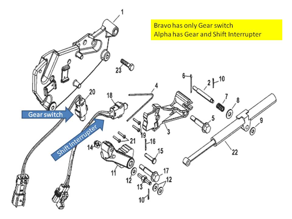

Look at the shift plate and see if the in-gear switch is adjusted correctly. Disconnect it and measure ohms and see if it changes closed (zero ohms) to open. Also with drive in gear giggle switch contact it some to see if it has intermittent contact
If you have an Alpha drive also check adjustment of interrupter
