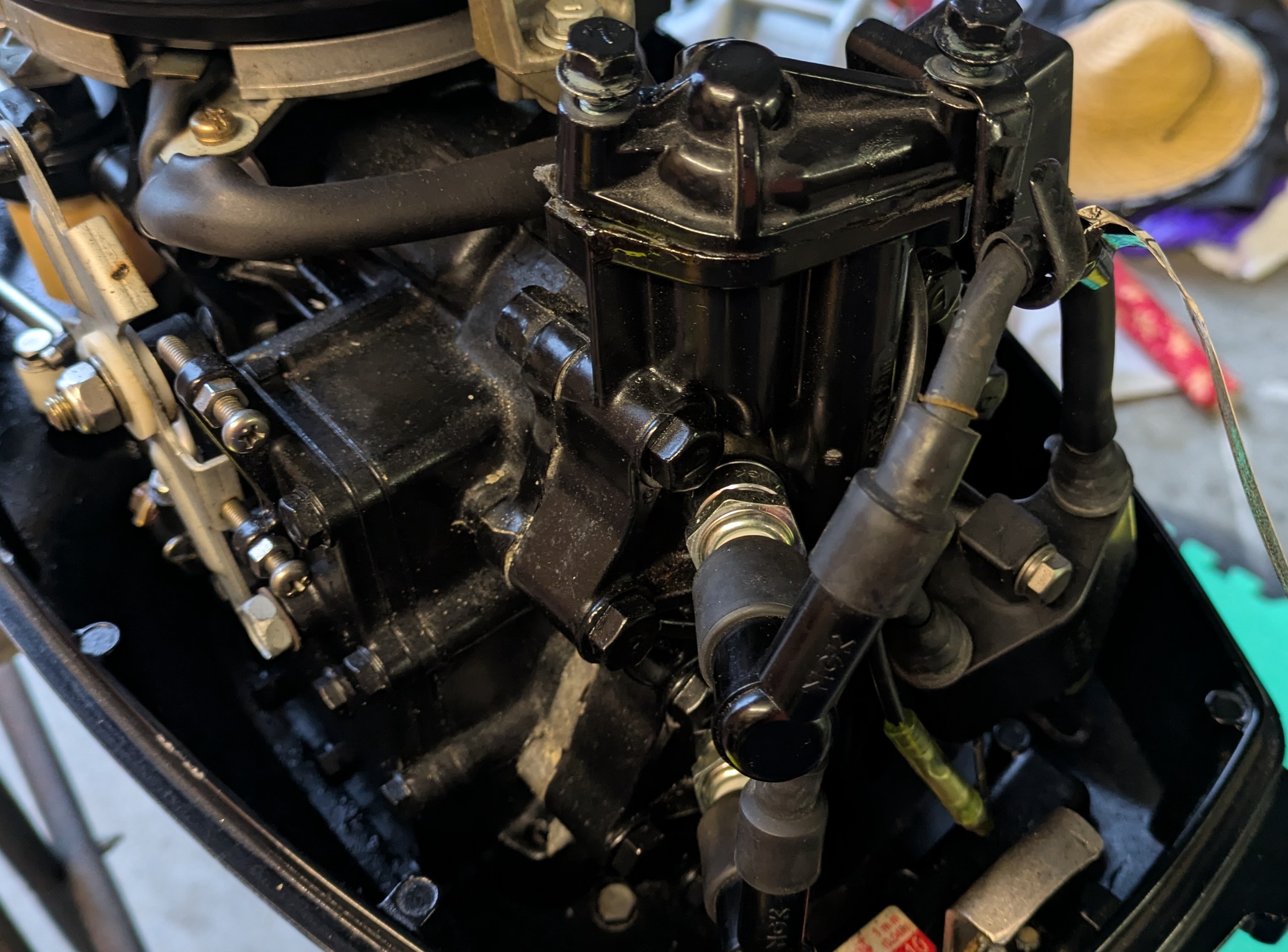

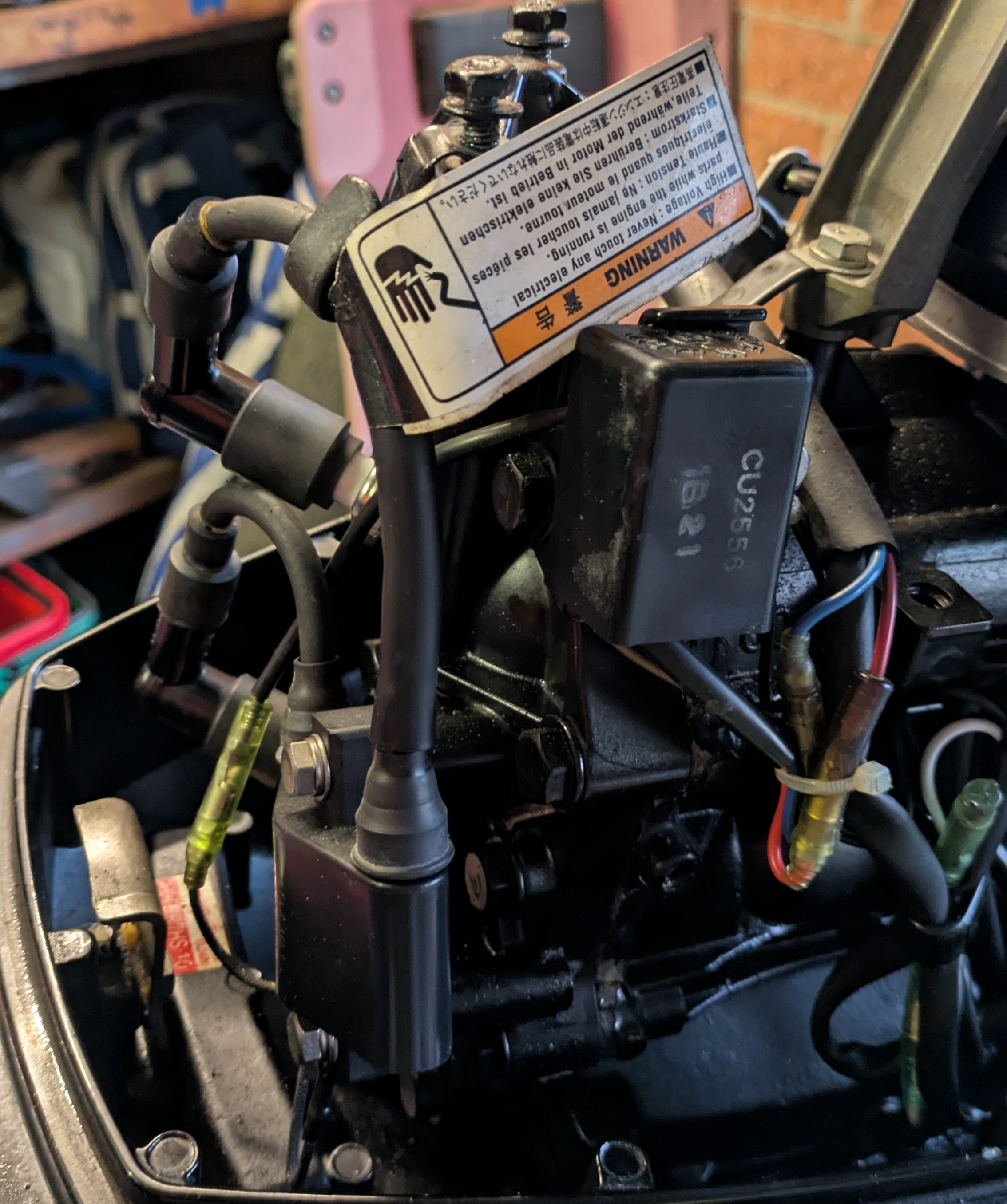

The tell tale isn’t directly connected to the exhaust, can you post up a picture of the back of the engine with the cowl removed, the thermostat housing should be at the back with a hose running down from there to the tell tale.
Defiantly no hose coming out of near the thermostat. Any outboard I've worked on always has a hose you can usually get to , to blow out etc on the telltale .

Is it a saltwater engine ? Could well be salted up inside, I would either remove the exhaust cover and have a look to see what state the water passages are or you could turn the engine upsid ev down and put some salt remover down the tell tale (Wessex marine Proflush or Rydlyme) to see if that clears it.

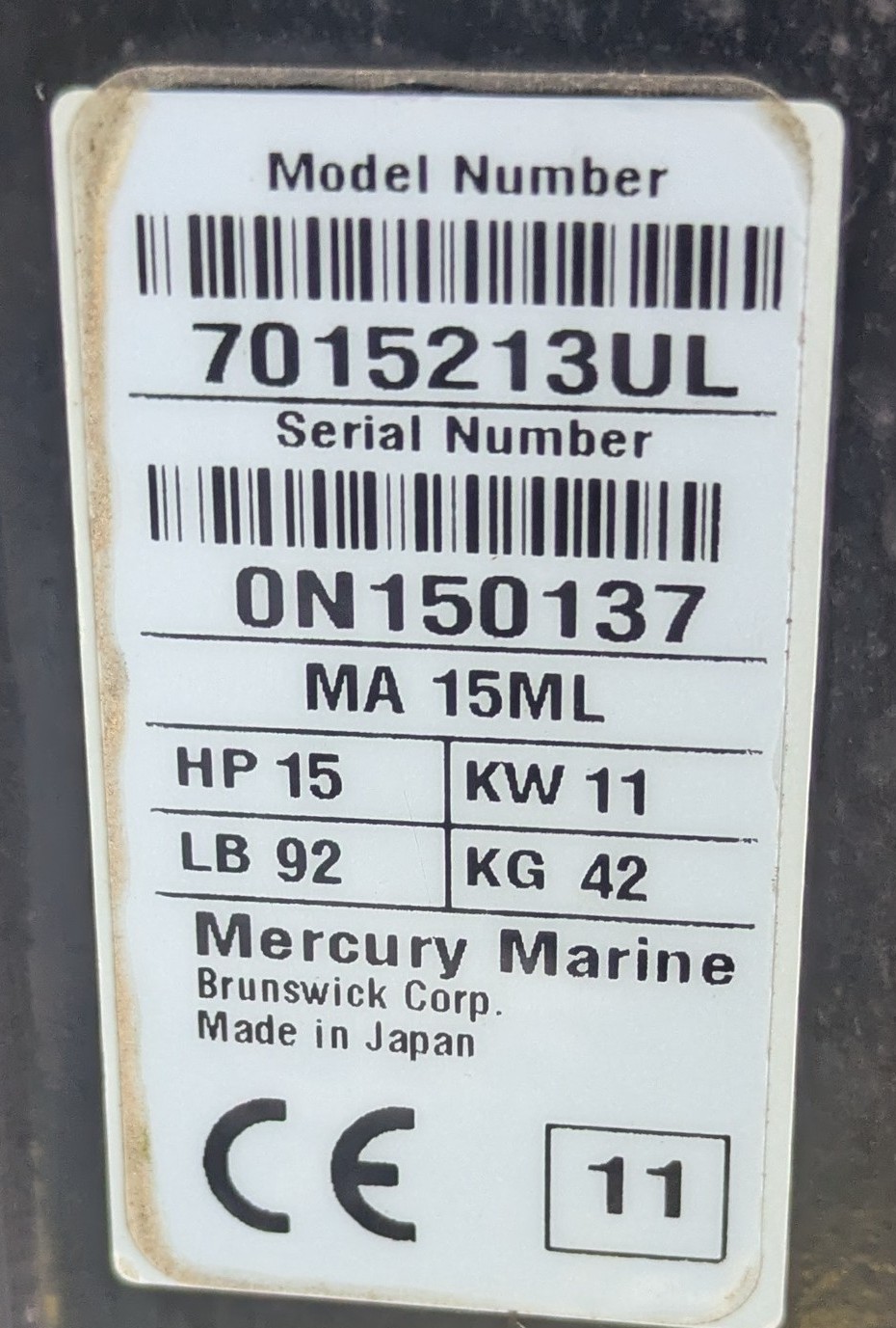

That looks very much like a TOHATSU model.-----Water telltale is likely using internal passageway.-----Not easy to clean.
