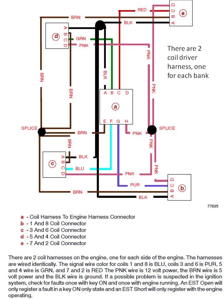

Looks like you have a bad connection or ECM
Each injector has a designated wire from ECM, Trace your wiring

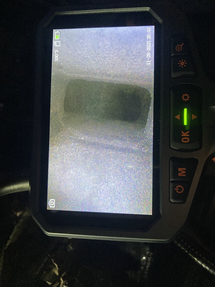

I might want to look inside that cylinder with an inspection camera just to make sure there isn’t a coolant leak causing the misfire.
I learned that watching Eric O on South Main Auto you tube, he used that camera to spot coolant leaking in a Honda CRV cylinder, apparently blown head gaskets happen on them fairly often.
On my 4.3 I started having a bad misfire, reluctance to start, and I just grounded the coil lead, removed the spark plugs and cranked the engine over. Sure enough water shot out of cyl #2. Blown head gasket. Repaired with new gaskets, cyl head bolts and reman cyl heads (originals were cracked from an overheat a few years earlier).
I would always do a compression test, leak down test (if possible) and cylinder inspection with the camera (easy now they are not that expensive) before touching the EFI system.
It's not that uncommon on marine inboards, they are under heavy load all the time and Volvo exhaust gaskets are known for leaking down into cylinders, especially the center ones. In fact I use that same camera to look inside the exhaust elbows to make sure they aren't leaking, very easy takes like 10 min (remove a plug on the top of the elbow, the camera wand fits right inside). Here's a pic:
no leaks!
