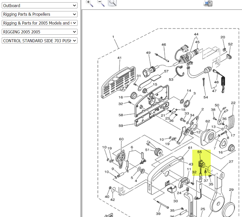

Helping a friend with this outboard, his up down button broke off. How do I figure out which 703 this is to order the part? It’s a right side mount.
When I look up parts drawings on line for
this outboard, under controls it shows nothing for the shift handle parts.

Yamaha service manuals are available only from Yamaha dealers. Or https://www.yamahapubs.com/
An exploded view of the 703 control box can be seen at www.yamahaoutboards.com
I presume that you are referring to the trim and tilt switch.
Thanks for the help, found the part number. The up down button switch failed, broke off, engine has only 38 hours on it and runs perfect otherwise.
