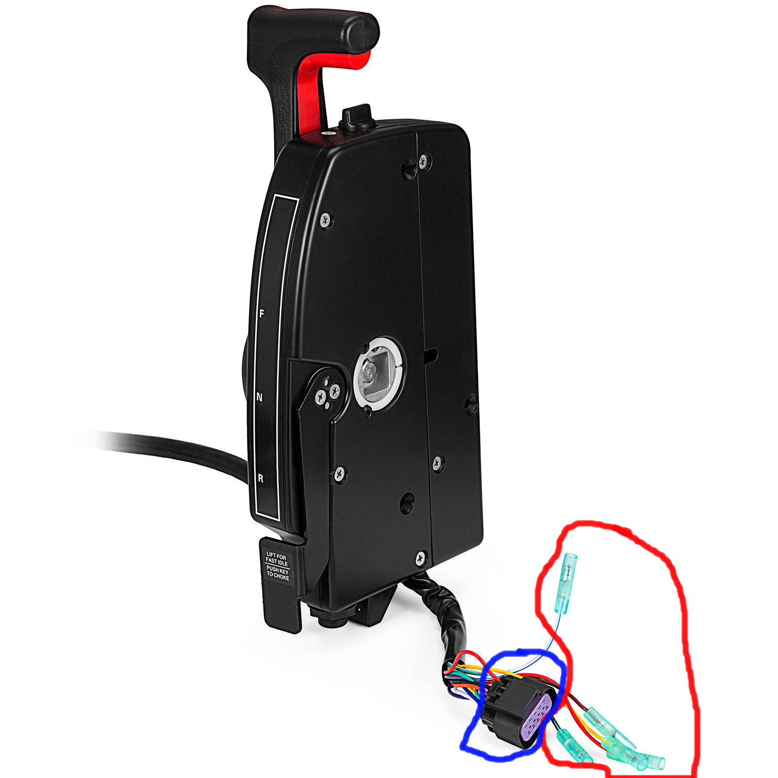

2nd issue is (what I think is a RPM limit alarm) if I try to go more than about 3/4 throttle in forward after I'm on plane... I get a buzzer form control box... the control box is a mercury 881170A13 and does anyone have the wiring diagram for the extra wires shown circled in red and what the connector shown circled in blue is for?? I have a tac on the dash but it is not hooked up to anything and would like to get it going.
