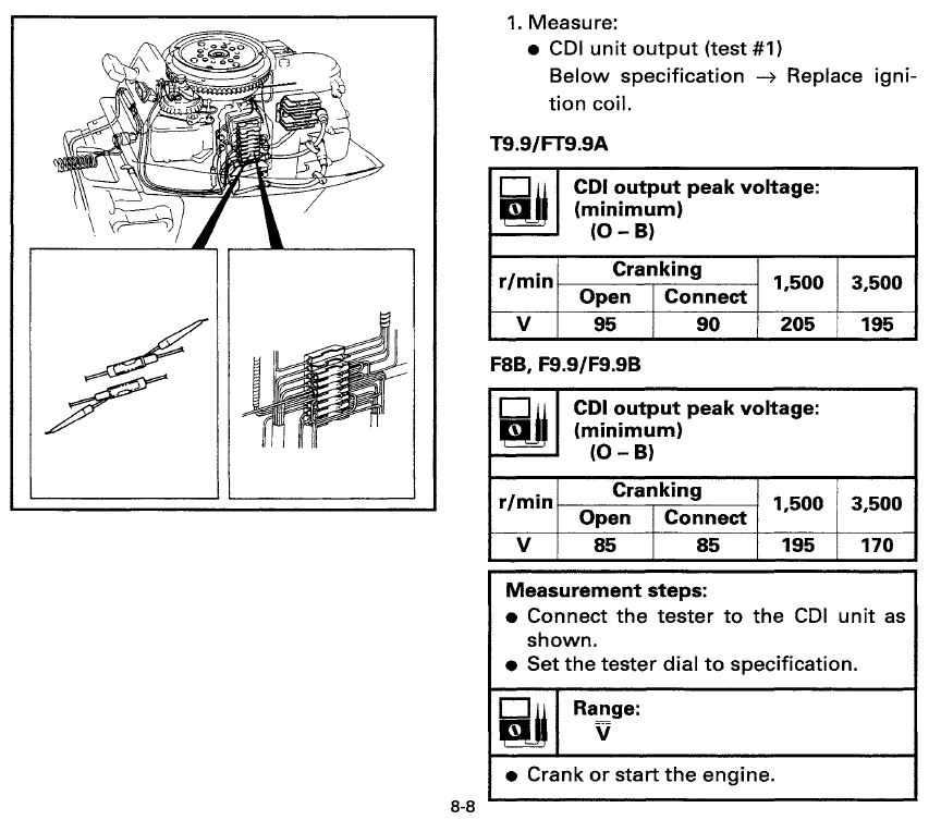

I checked the manual for troubleshooting and one of the tests they have is to check the CDI by probing the orange and black wires and checking for voltage while cranking.
The Voltmeter doesn't register any voltage. It says to replace ignition coil if you don't get he 85v but I don't understand how that could just suddenly fail. Anyone familiar with this motor that could point to something other than the kill switch that might cause it to lose spark suddenly?
