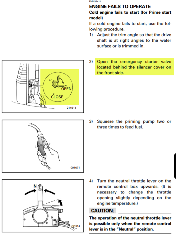

That model uses an automatic fuel enrichment system to add extra gasoline during a cold start. Is it set for the automatic position? See illustration below.
Are you cranking the motor with the throttle in the idle position? That is normal but you might want to try advancing it just a tad to see if that helps.
