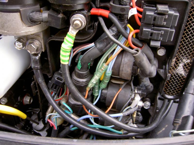

Hi all, I have a Four Stroke 2003 Mercury 75 Hp outboard (just got it) I have it running but cant find a wire that sends the signal to my Temperature Gauge.
The book says it should be a TAN coloured wire from the engine but I can't see one under the cowl.
There is a heat sensor on the engine block that has one Black and one Black/Yellow connected to it but the book says I should have a TAN wire to connect to the Temperature Gauge.
Anyone have any clues.
The Serial number is: OT 807538
and the Model number is: 1F75412CD
Many thanks
Mark
