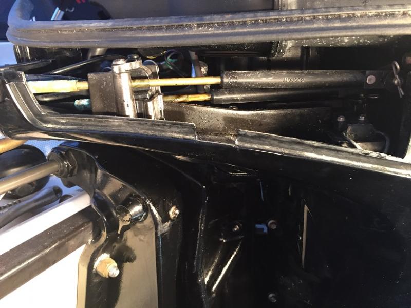

speaking of my Merc 2003 115hp efi motor
Shifting into reverse is not smooth
it's that first inch of handle movement that I need to pull then once in gear the handle moves smooth. I've been dealing with it for awhile and figure now maybe I look into it.
It's just a bit frustrating when putting into reverse, I end up reving the motor to much.
I'd think it should be more subtle
any ideas?
shifter control close up paint.jpgshifter control paint.jpgthanks Jeff
I'll see what my Clymer manual says.
I do know it does talk about the 'ring' my finger is pointing at.
Seems odd it's being pinched by the cowling
any thoughts on this?

o I've made several attempts at adjusting the stiff shifter.
but when it's easy to get into reverse it's also got quite a clunk in the gear case when going into gear.
I know these motors are not slient when going into gear but how much clunking is acceptable
the following link is a utube video of me changing gears. am I good to go or keep working on it to get the gears to slip more seemlessly
even it if means stiff shifting?

I've been playing with the adjustment and can get it to shift easy but with clunk.
stiff shift no clunk. I"m going to try to dial it in so some stiffness but less clunk.
I called the merc dealer yesterday on another matter and brought my stiff/clunk issue up with him.
I'm told my motor was one of the first EFI motors Merc worked with Yamaha on. Notorious for shift shifting.
so much so they were offering new lower leg gear unit swap while the motor was on warranty. so if an owner was lucky enough to find out about this 'recall' they got a new lower unit. Once out of warrenty (like mine) the owner would have to pay full price ($5k up here in Canada)
In any case thanks for your info, winters here, freezing and the boats put away. Will do some adjusting this winter then see how quiet it is some spring (April).
