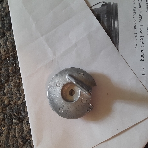

The trim tab/anode WILL work. The LU is the same type of casting. On the newer 4-strokes, they sometimes have the round anode AND the anode/trim tab. You may need to trim the pointed edge of the trim tab anode to get it to seat correctly. You can also add a skeg-mounted "torque tamer", but they are usually not needed.
Hi
Is this the one you were talking about? The arrow and anode will need to be ground off to fit.
I am wondering if just the bolt will hold it into position.
Probably be just fine. Use some never seize on the stainless bolt, so it doesn't corrode into the aluminum housing.
