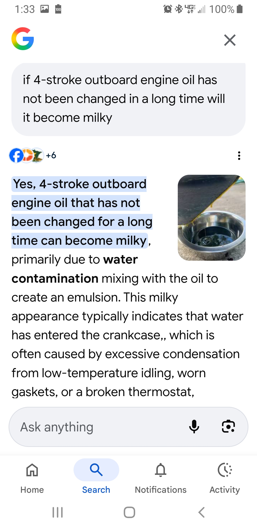

The Oil filter I took off was Dated (5/23) , I can only assume that the last time the oil had been changed was in May 2023..
I did a Google search ..
"If a 4 stroke outboard engine oil has not been changed in a long time will it become milky"
Here's what came up..
