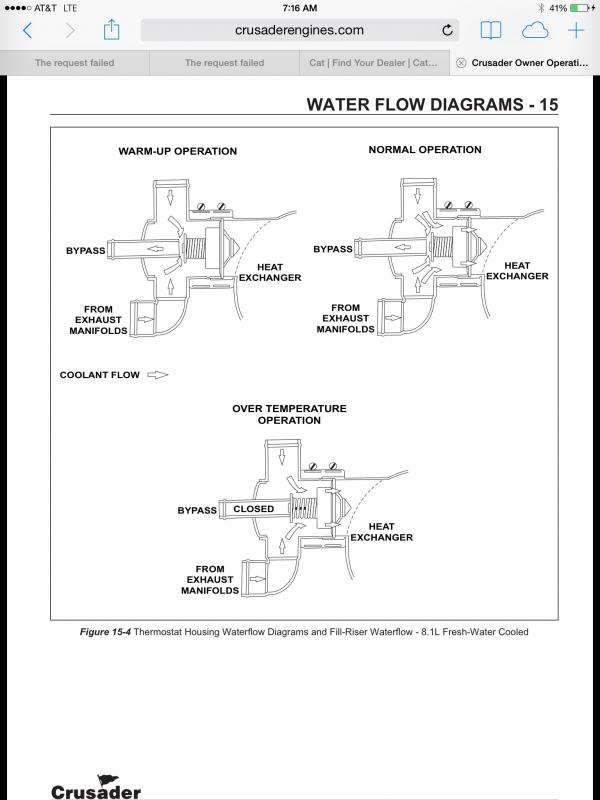

Starboard engine is now fixed. While I had the heat exchanger out for repair I decided to replace the thermostat for the heck of if as it was part of the heat exchanger assembly and the system was already drained. After refilling the system and purging it of air. I have retested the engine several times and it appears the issue is gone. In my opinion the heat exchanger cap issue was caused from all the testing and messing around with the cap. It was the thermostat that was causing the issue. The mechanic talked to crusader and after he looks a at the thermostat diagram as he had some questions. It seems that the thermostat was not opening fully and causing excess pressure to build which was forced in the overflow tank. However the engine did not overheat. What ever the cause I'm glad it was cheap and the engine did not have any major issues. Thank you for everyone's help. I plan on replacing the neck and thermostat on the other engine. As I'm due for coolant replacement and might as well service that engine while the coolant is drained. See attached diagram of thermostat operation. image.jpg
I am glad you found it and it did not cost an arm and a leg. Crusader uses several "bypass" schemes, depending upon the year and model. Engines need some way to circulate some coolant to the block even when the thermostat is closed. In my case (I am assuming here that my boat survived the recent hurricane in Cabo) one engine uses three extra holes in the thermostat, so it never closes all the way. The other engine does not have the holes, but uses the path though the water heater (just as a car engine uses the heater core) to provide the bypass.
Both those approaches are pretty much failure proof. In your case (same year, bigger block) Crusader opted for a more complicated approach with a special thermostat. Don't know why, but there must be some advantages. My Kohler generator also uses this type of thermostat to open and close the bypass, only smaller.
