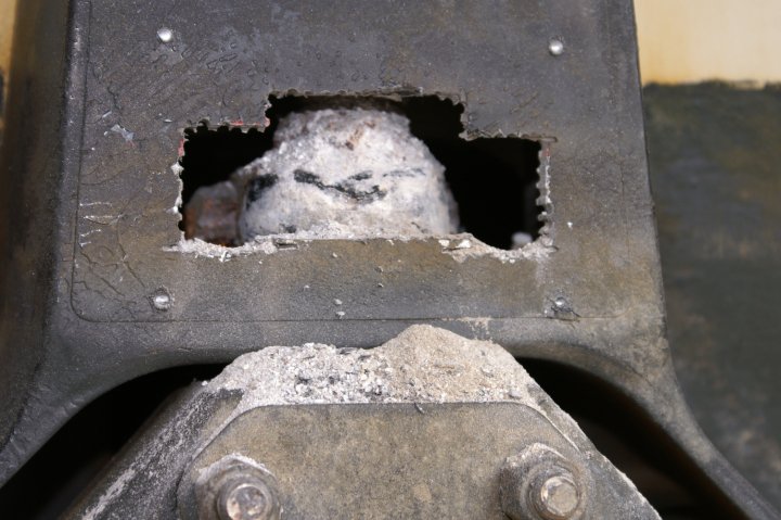

The wear we are talking about is just that, wear, on most. Other contributing conditions are improperly torques u-bolt or docking the boat in a shallow slip where the drive will come into contact with the bottom. When this happens(drive contacts bottom) The boat is rocking and moving in the water and the drive is static, fixed in the sand, mud or rocks. All the weight of the boat moving and the drive not moving puts much stress on the gimbal ring at the steering pin connection. Once you get a little movement in this connection point, normal operation of the boat will increase this wear as the drive bangs back and forth until the boat experiences extreme drift in a straight line or failure of the gimbal ring.
This past season I condemned a vessel for use due to eight inches of swing in the drive. Totally uncontrollable.
The picture I posted above is of a Chaparral. He was docked in shallow water and also suffered a swivel shaft seal failure. This transom assembly was repairable as was the gimbal ring.
