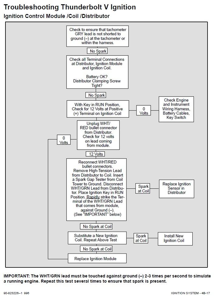

Getting 12 volts to postive side of coil, 10,000 ohm reading between + and coil output. Only seeing 0.05 ohm between + and - on coil. Not getting any spark to distributor. Tried a second brand new coil with same ohm readings on it before install. Same out come. Wires are only 3 years old and in good condition. Boat is a 1 owner, and have never had any issues starting prior to this. Any ideas of where to start looking? I am suspious about a grounding problem, every other electronic on the boat is working as it should.
There is a complete troubleshooting procedure for Thunderbolt ignition systems (which you have).
First thing to check is the shift interuptor switch on the shift bracket. There should be a two wire terminal strip. Remove the White with green ( there should be two wires on that terminal. One to switch other to distributor wiring. do not allow the wire going to distributor to touch any ground.
This elimates switch from circut.
Not retest for spark. if no spark still, read below.
At the back/side of distributor, there should be 3 wires coming out of the distributor itself with bullet connections.
1. White with red stripe
2. Black -GROUND
3. White with green stripe.
With ignition off, disconnect white with green.wire. keep wire ends away from ground/metal.
Connect spark checker to coil wire after removing from distributor side.
Turn ignition to the ON/RUN postion.
NOT cranking position.
With the white with green stripe wire the wire which goes to the timing control module in your hand, Strike end to ground rapidly and see if you now have spark.
If you now have spark, replace pickup sensor in distributor.
Report back with results
