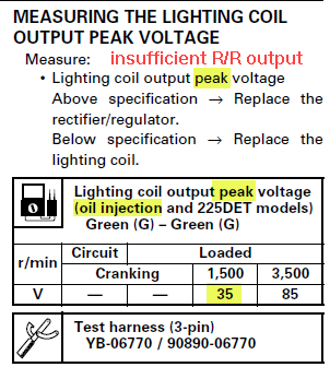

I have a 2002 yahama 150 VMAX 2 stroke. It’s only making about 12.0v at idle and throughout the rpm range. I disconnected my battery while engine was running and it did not shut off, I checked the AC signal coming from the Stator and got about 10.0vAC per wire. There are three green wires to the rectifier. Does that sound right or is that low?
