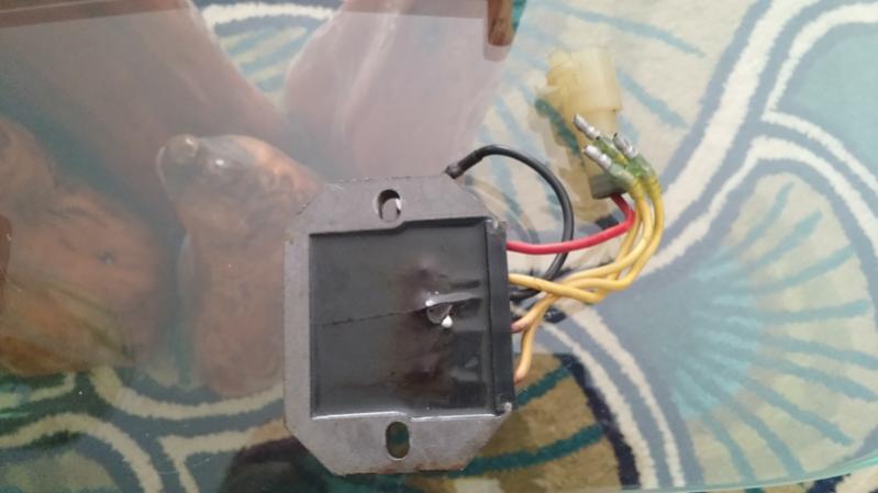

OK... Sorry for the late reply. Between the hurricane and all the wind for weeks on end this thing has been parked anyway. So, today I finally pulled the rectifier to test it and found this! It's obviously toast. What would have caused this? Are there other things I should be checking before installing a new one?
I found a video on youtube on how to check the diodes on this type of regulator/rectifier. It looks exactly like the ones used on lots of Jap motorcycles. It passed the diode test. But, obviously something wrong because it is melted.
The bakealite material is cracked and some molten metal oozed out of the crack. rect.jpg
Your motor has a 3-phase alternator, so the rectifier/regulator is more complex than just a bridge rectifier. Yes, it appears your rectifier has failed, based on the solder leaking out of the potting.
Use your Factory service manual as a guide, and test the alternator (which is probably fine), and then feel free to install a new regulator. The current part number for the regulator is a revision (new version) from what was originally on the 25/30A, probably a more durable version.
