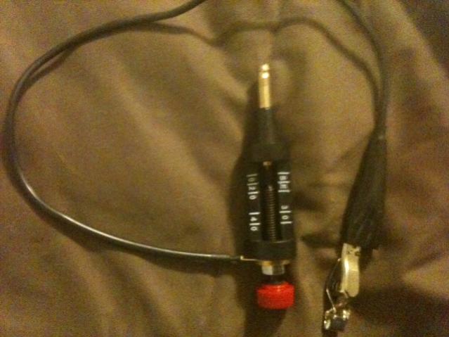

Here is a tester that I got from AdvanceAuto, it was cheap and you can set the gap to what you are looking for, in this case 7/16's, if the spark wont jump, then you can reduce the gap until it does jump and therefore have data to use to solve the problem. Sparkplug tester.jpg

no it does not keep running ...even giving a little throttle starts and then quits...gonna go get spark tester to check each cylinder for proper spark...meant to say have not had carbs cleaned or serviced since i bought new..drained the bowls on all 4 seemed real clean...only on 4th tank since installing new one...thanks 4 your help really appreciate this...need to get running ...get back on the ocean...joe
