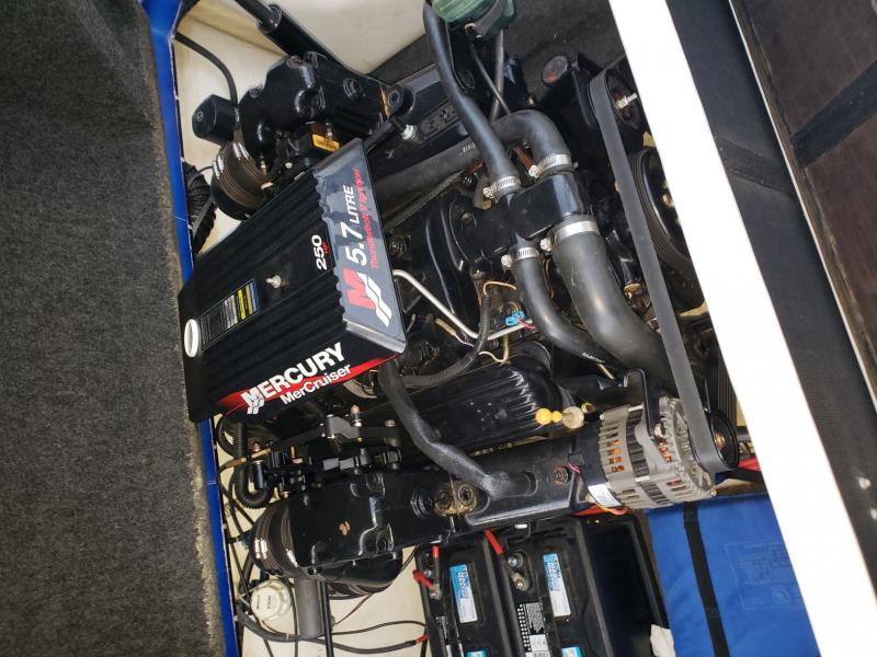

I recently purchased a boat with a mercruiser 5.7L , the engine is a 2001 model 4312025N1. I took it out for the first time a few weeks ago and the first day it ran perfect no horns sounding. The second day the horn would make a single short beep when reaching 2500-3500 rpms. All fluids were topped off , oil pressure was around 35psi and temp stayed right around 160. I did not notice any performance issues when this was happening. From what I have read the warning system on these older mercruisers don't even have a single short beep and all alarms are a continuous beep or none. I dropped it off at the mechanic and they went thru the boat and couldn't find a single issue with the boat and couldn't replicate the problem. The mechanic also confirmed that this 5.7 is a basic carbureted model with a basic warning system (on or off horn and no multiple beeps) and no computer to check. So I am still trying to figure this out. Any input would be appreciated.
