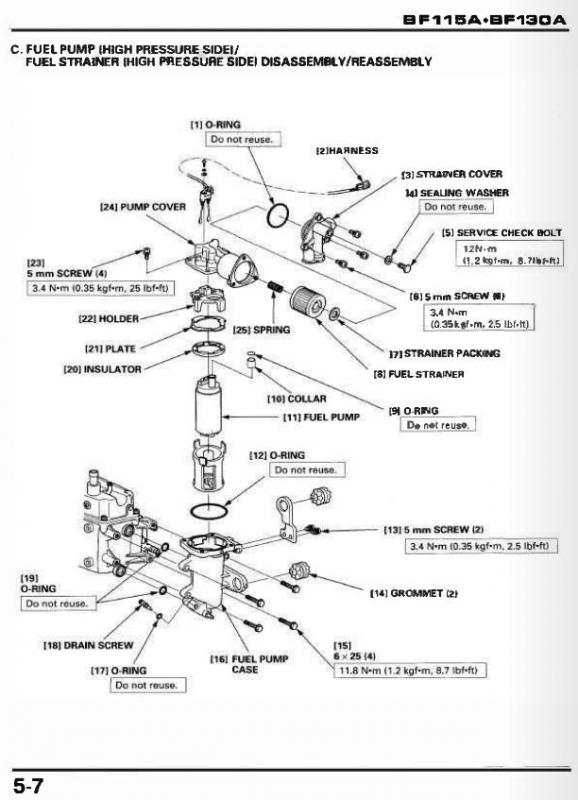

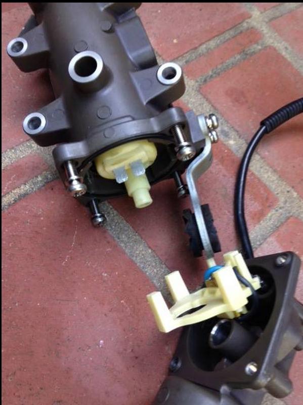

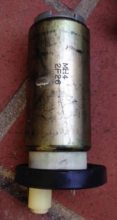

I think I have a 2001 BF130A fuel injected Honda outboard. Fuel pump is bad. It is the high pressure fuel pump right before the fuel rail.
There is no part number on the casting.. I am hoping the fuel pump which is inside with the two spade connectors can be replaced / rebuilt, and that I can find the parts
I would be very grateful for any help!
