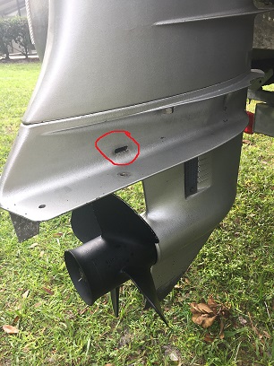

Second issue: oil leak.
Oil leaks out of the foot. It doesn't leak when not running, but leaks when running and after turning it off. I did an oil change after cleaning out the scale. I don't see any leaks under the oil filter or below the valve cover. How can I tell if it is leaking from the lower seal around the crankshaft?
Any help would be appreciated.
