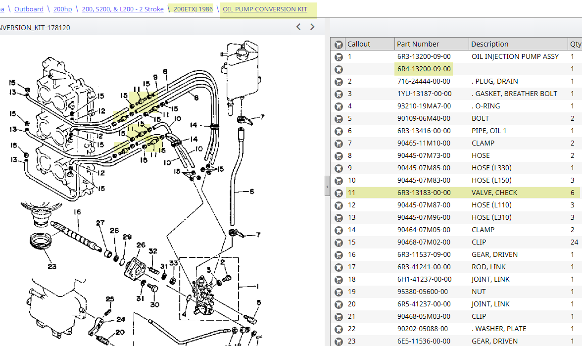

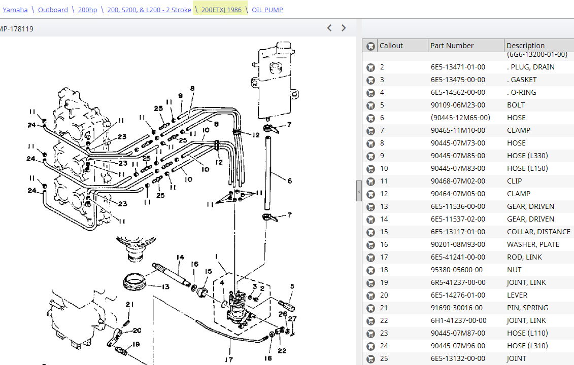

Seems that the internal check valves on the original Keihin pump have failed. Intermittently. The replacement Mikuni pump uses external check valves. The original pumps have long been rendered obsolete.
Your mechanic seems to be quoting you for Yamaha check valves. Which are higher in price than they otherwise might be. If it were my motor I would not be hesitant to use a non OEM check valve. Or search for pickapart motors that have check valves on them.
