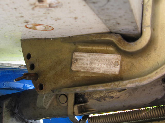

The model no. is for a 1977. This is the 50th anniversary edition. I do know when looking up parts you have to go back to 1972. I looked up the model no. on line and it also says it's a 1977. It does have points and mags. I got the model no. right off the factory plate on the motor.
The plate says it's a 20BA77S. If you look for a 20 HP in 1977 there is none. I believe it goes from 18 to 25 hp.

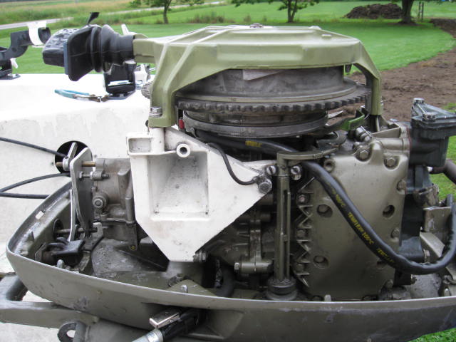

Here is a picture of the mag plate, and the model # tag I checked the timing and the mark on the flywheel was in between the two marks at an idle. I disconnected the fuel line from the tank. It didn't smooth out just before it died. Checked the points.both sets are at .020. There are no grooves in the flywheel key.

I did pull the needle for slow. I checked it for being smooth in case someone tightened it too tight. When I put it back in I turned it out 11/2 turns as you mention. I did start the motor and let it warm up. I adjusted the needle in gear until it ran as smooth as it was going to. I just checked the synchronization and found it out of specs. I adjusted it according to the service manual for the ignition system on this motor. I haven't tried to run it yet.
Boy, this can get confusing. The service manual I'm using is on line. It shows D-3 for the adjustment. I'll look again in case I crossed my eyes looking at it. After making the adjustment with the D-3 setting it did seem to run better. I did notice the cam is worn and the cam sleeve has a flat spot on it. I just ordered both parts.
I just looked in the manual again. Apparently I did cross my eyes. It is C-3 for 72. must have been looking at 71. Thanks for posting this to straighten me out.
The cam has 2 notches. There are wear marks on the cam like someone ran it in one position whenever they ran the motor. After adjusting so the cam sleeve was between the marks, the throttle control had to move too far to move the throttle shaft. The cam is worn that much.
I gave seaway a call. I guess I have a mystery motor. They have no listing for that model no. They did tell me that if everything was working from a 72, keep doing that.

For a number of years the 20 HP was only marketed in Canada.------------------The motor that the original poster has is a 72 model painted green and the 50th anniversary year.----Likely had the transom bracket or model plate changed.

The bracket is easy to change and the identification plate is easy to change.-------The paint is harder to change !!--------The motor in post 21 is indeed a 77 model as per the 77 on the identification plate.
