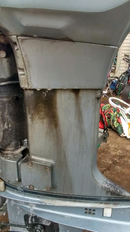

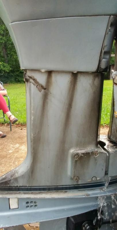

2) I noticed some new stains/streaks on the midsection of my 1985 Evinrude 70 hp (see other pics). Anyone know what's causing them? Too much oil in the fuel, maybe?

Remove the lower covers from the outboard for a better look at where the oil is coming from.
