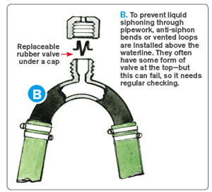

Just gone to start my engine after the cold spell and have water spouting out of what looks like a by pass vent its a pipe coming off the top of the engine through this breather and back into the outlet that pushes the water back into the river....any ideas why this is happening???????
