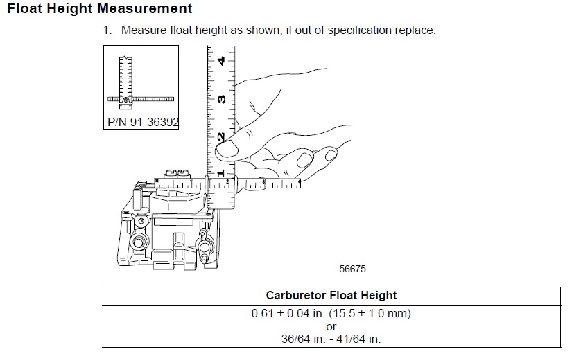

Agree, you can't adjust the float, but did you measure to see if it was within spec's.
If not you "must" replace it.
And it could definately be the cause of the flooding...

Thanks for all the ideas. Here's the deal, I pulled the carb off again. Measured the float as per the attached spec and it's dead nuts.
Now I understand the whole adjustment per Jeff, but how do I do this with a plastic float? The needle slips under a little plastic tab and that's it. No way to bend the plastic without breaking the tab off I imagine.

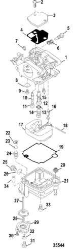

I have attached a picture of the carb. Can you tell me what number you are talking about when you mention the rubber plug?

Re: 15 HP Flooding
Dave, please find attached an image of the top of the carb. From what I can tell, there are two brass jets in the lower right. Is one of these #7?
I am removing the carb in a few minutes to check for #11.

Re: 15 HP Flooding
Do you still have the rubber gasket you removed from there can you post a pic of the underside of it. See the brass part to the left of the big air passage you just see a little bit of that screw is that screw capped off in the side of the carb. See the bis opening in the carb to the left of the lower screw hole in the picture. but the parts listing is saying #7 is a screw in your case, i can't find a part number for that jet even up to the 25 3 cylinders 3 carb motor.
I need to see the bottom side of that gasket to see if there is an imprint of the jet on it or not.

Re: 15 HP Flooding
Let me look at the tohatsu books tomorrow and see if I can come with up something, by looking at the gasket it does not look like your carb has that jet, it is usually used if the idle air screw is not there but your is and not capped off surprisingly. Tohatsu does not use that jet only merc that I can tell. if it had it you can clearly see the imprint of the cross on the rubber. I am confused as to what #7 is in the drawing though and it does show it on my merc parts look up as well but not in the manual strangely. if you put a hose on the fuel inlet and hold the float closed can you blow any air into the bowl at all. I am starting to think you either have some dirt in the seat or the needle is no good. but if it is seating there has to be a gasket or seal missing in the carb somewhere, like the OMC that have that stem gasket that seals against the float bowl if not there they will flood at high speed and just die.
Was the rubber plug installed on the jet in the bowl.
