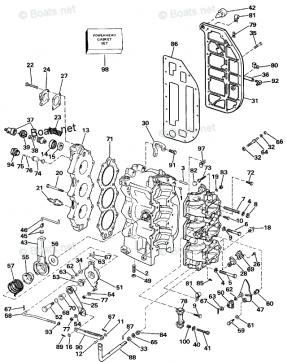

Disconnect your remote cables for the time being from the trigger arm . then disconnect the linkage for the butterfly's from the trigger arm .then get a timing light and adjust the timing you will see the 2 screws the top one is the trigger stop screw for idle there is another one on the top of the block with a rubber stop on this one is for your WOT timing .put the timing light on no 1 piston HT lead .mark the TDC mark on the flywheel with white paint and also on the arrow indicator mark i don't know if your model firers on TDC or between TDC and 4 degrees i think its TDC [check this or someone on here may know] make sure your battery is fully charged turn the motor over and adjust the screw so that the 2 white marks line up as you turn the motor over with the key [ or get a press button switch and connect it to the solenoid ]. once you got the white lines lined up then before you connect the linkage for the butterfly's make sure they are all closed once you happy they are closed then carefully connect them to the trigger arm .make sure the trigger arm is against the idle stop screw .you may need to adjust the butterfly linkage to suite at all times make sure the butterfly's are closed and the top trigger arm is against the idle stop screw once this is done then check and adjust the nylon roller. the cam it rides on has a line on it this line should be in the center of the nylon roller and the butterfly's must not move when you do the final adjustment you can increase or decrease the ignition idling before you connect the carb linkage it should be +/- 750 rpm adjust it till you happy i always start the motor after doing the ignition timing before connecting the cables when you connect the cables do it carefully so that you do not move the trigger arm and adjust the cables to suite the trigger .i hope this may help you.
MjM3Njk-7dab6fb9.jpgno: 9 is the ignition timing idle screw adjustment
