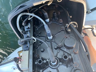

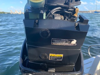

I have a 17' Mako Center Console with a 1998 90HP Mariner 3 cylinder serial # O[FONT=Arial, Helvetica, sans-serif]g748015[/FONT]
[FONT=Arial, Helvetica, sans-serif]I'm a first time boat owner and a rookie to say the least. The motor is shaking (bouncing side to side when at idle) which i'm thinking the mounts are bad, i watched utube on how to tell and they are bad, both top and bottom and severely corroded. i have the IPB's for the R/R of the mounts so no big deal. Just wondering anyone's thoughts on any other possible problems it may be.
Additionally when i throttle up on the control lever, it it kinda delayed.... like it takes up to like 10 seconds for the motor to catch up to the control. What do you think the problem is or is this normal? I know a 90hp isnt going to push your hair back right away but with my experience in A/C maint, usually that means the power cable or fuel problem. Unsure.
What spark plugs and wires are the best to replace the old ones with?
Also is is best to buy Carb repair kits for each carb or just take them apart and clean them first? Is there a specific fuel additive i can use to help clean out the build up and for prevention?
[/FONT] IMG_1882.jpgIMG_1883.jpgIMG_1894.jpgIMG_1897.jpgIMG_1895.jpg[FONT=Arial, Helvetica, sans-serif]
Sorry for all the questions, just trying to get my motor to where it should be and continue to upkeep.
[/FONT]
