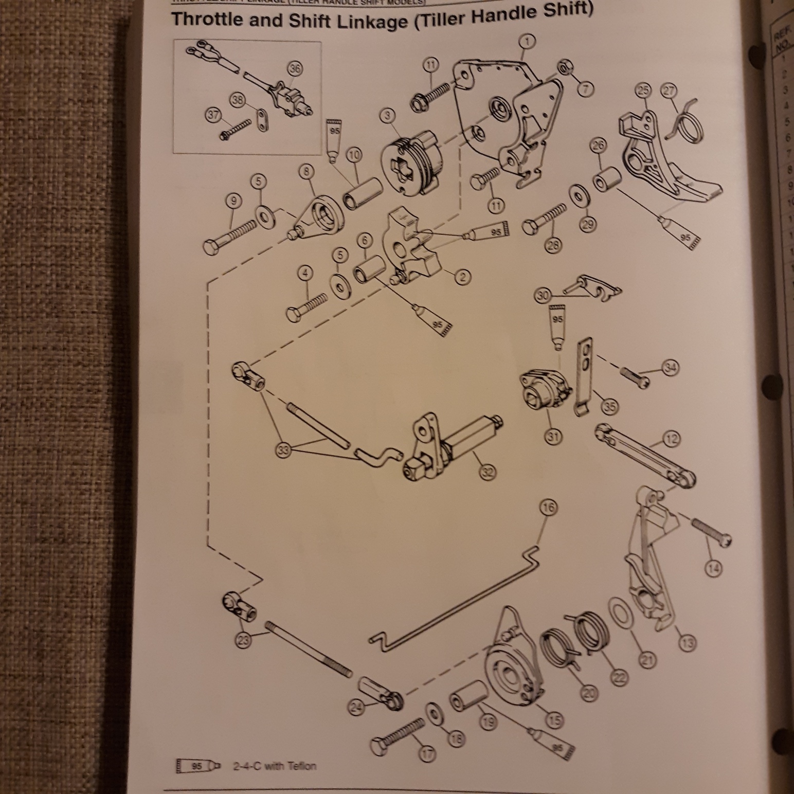

There is a long line of components between the twist grip and the actual reverse gear.
I've got a new tiller handle pulley with shift/throttle cables and did some greasing...that is operating very smoothly.
The lower unit is relatively new...the shift shaft goes up and down smoothly.
That leaves the plastic pulleys and gears, horizontal shift shaft, the shift-shaft yoke, and detent spring.
All of these have been greased many times with 2-4-C w/teflon. Would it make sense to
take all of them apart, clean them up, and put it back together with fresh grease?
Should I use a de-greaser? Or, just wipe them clean?
