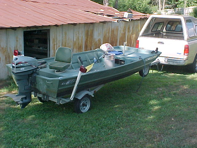

I had a thought of mounting a Tach. This is a thought, not a desperate Repair.
Anybody have a schematic that would show me where to hook up the tach, the ground and maybe enough current left over to put a small LED for night work.
I put a new Power Pack on in 2001. Cant recall if it's aftermarket or not.
