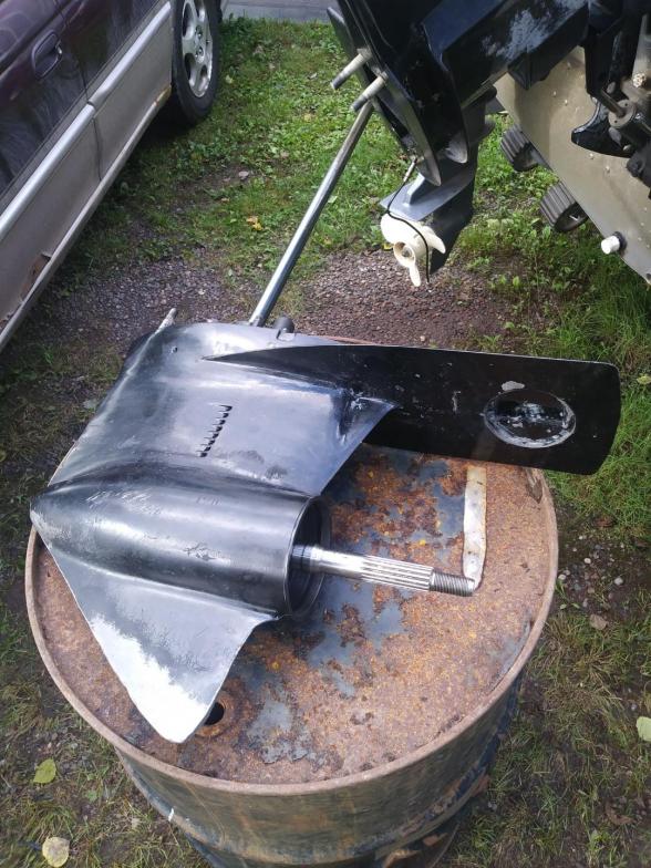

To place a percentage of efficiency is difficult. The wrong prop can easily cost you 15 percent as well. True, jets have their place and by comparison have a safer history as well as less moving parts. I can't begin to list the repercussions of a hard rock strike with a stainless steel prop. I repair props and skegs, sometimes the prop repair itself is just the "tip of the iceberg". This rock strike cost my customer about 2000 bucks. That is the same housing, before and after. Prop shaft was bent. Driveshaft and even crankshaft damage is not uncommon.
