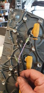

It also has a cylinder temp sensor fitted 34820-5D20, on the head between #1&2 cylinders. This has a purple/white lead set coming from it, which doesn’t correspond with anything on the ECU. I’ve found a photo of a 2000 model and it has the sensor, but it’s not wired in. Is this a obsolete carry over from the carby models?
Any ideas on why it’s having the temp warning go off and throw it into limp mode?
