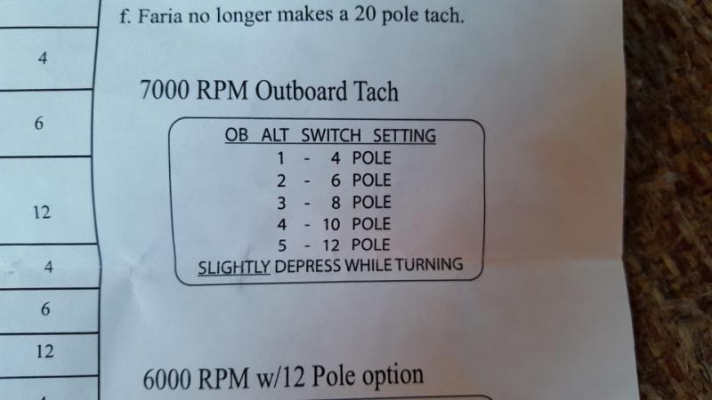

I put in a new inlet needle and found that the old one was worn and the float was a little out of adjustment so did the float too.I then cleaned the fuel filter with carb cleaner even though it didn't look dirty to me.Then I did a careful link and sync. I think I got the idle on but the tach is reading 1600 rpm's which I'm now suspecting is not correct. My service manual says this engine is a 12 pole and that's what the tach is adjusted to,any lower and the rpm's are reading higher. This is the highest setting on the tach I can go so I don't know what to think about what could be going on. It's a Faria tach and I'll call their tech department today. I also ordered a Tiny Tach to compare before I do anymore trying to adjust the carb. What do you think does it sound high or on?
Set tach at 6P.Most Mercs are 6P
[FONT=Verdana, Arial, Helvetica, sans-serif]30/40 HP, USA Serial 0G53314 and up[/FONT]
[FONT=Verdana, Arial, Helvetica, sans-serif]12[/FONT]​
[FONT=Verdana, Arial, Helvetica, sans-serif]6P[/FONT]

http://www.foreandaftmarine.com/ob tack guide.htm If you have a 12 pole stator,the tach is set at 6P,the explanation as to why was posted here not so long ago,I'll dig it up as my memory is not what it used to be.
As I've said my serial # is below 53314 it's 465407. Since my motor is a 12 pole any setting lower than 12 pole and the tach will read higher.Since I suspect my tach is already reading to high it doesn't make any sense to put it on a 6 pole setting. I've already set it to 4 poles according to the suggestions that came from Faria and it pigged the reading at 7000 rpm. I've talked to a Faria tech and he agreed setting it to a lower setting would have the opposite affect of what I want.I'm getting my Tiny Tach today then I'll be able to compare and go from there.Thanks for your input.
