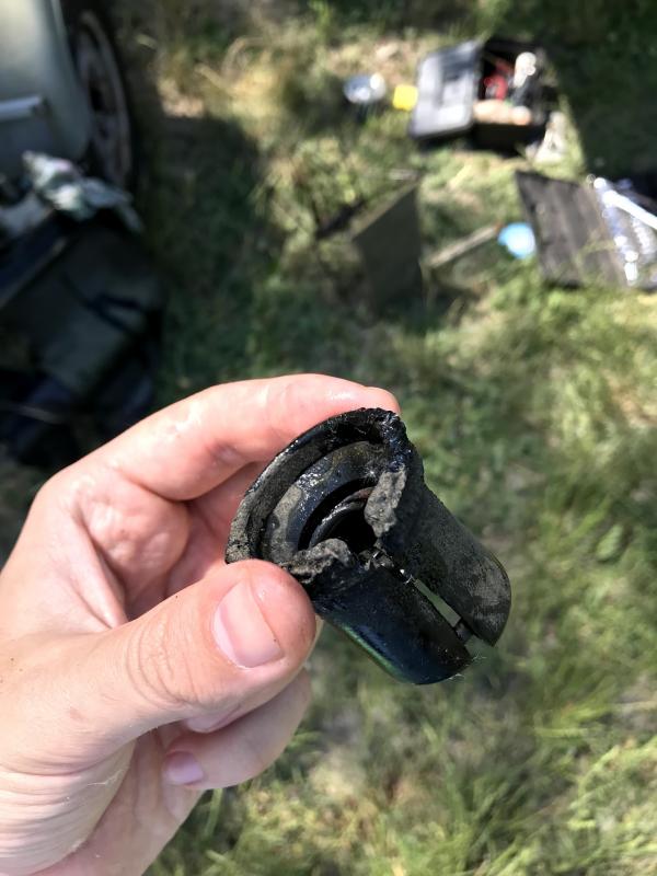

You probably right, I removed the thermostat yesterday, nothing changed, checked water channels for corrosion, they look pretty clear for a boat that used on fresh water. Now I am reading complains about Sierra impellers, people have too many problems with them, so I decided to recheck the water supply and I got about 1 gallon in 15 seconds at 1000-1200RPM, but then I decided to drop the RPM as low as possible (probably around 600) and water flow stopped. I think my Sierra impeller might be a problem so I ordered new OEM impeller kit together with the housing, will need to get the boat out of the water (this is the hardest part, that's why I hoped that the problem is somewhere in the engine) and change it up later this week. Will let you know if it fixes my overheating problem in case someone curious too.
My overheating on idle problem was caused by this little guy.
Good catch,
Jeff,
On the Gen 1 there is a short plastic "guide" tube I call it, that sticks into the impeller housing that the copper tube slide into and into the impeller housing.
On the Gen 2 (in his picture) this is what is used. Just a different design for gen II
This was most likely allowing exhaust gasses to enter the raw water stream, Speaking of which.
Make sure that rubber DAM is in place if not or it is battered, REPLACE IT!.
I will post a pic of the assembly in another post
