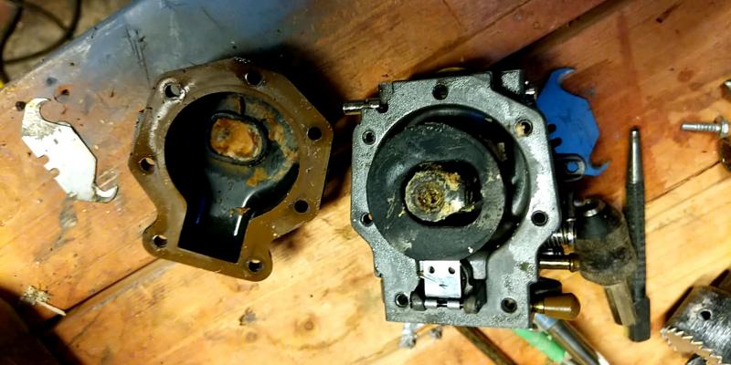

I bought a 1996 Johnson 15hp from a guy at work for $50. He told me it didnt run.. no big deal to me.. First thing i did was pull it to see if it have spark after i pulled plugs... it did. Plugs were a little black but nothing bad. checked to see if fuel was getting in the cylinders... there was none.... over to carb... drained the bowl. re primed. checked again... nothing... i pulled the carb out and well i found this..... 5300.jpg
Cleaned it all out with carb cleaner, made sure jets were clear. put it back it. Primed again, pulled sputtered and that was is. Looked in the carb could see fuel was getting in. so fuels out.
Im at a loss here. Spark--check, Fuel- Check. Something I'm missing? primer bulb was kind soft after pulling but when i took it off the tank and covered the one end and pumped it was hard. I had had a gal of fuel in the tank( Its new fuel mix)

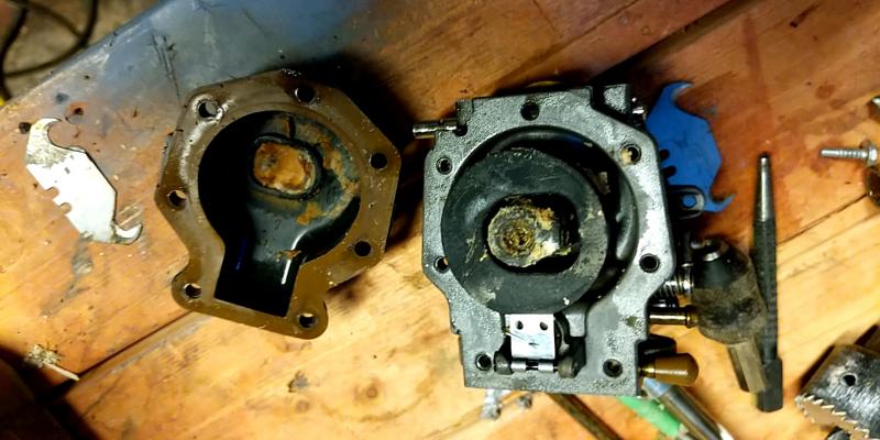

I bought a 1996 Johnson 15hp from a guy at work for $50. He told me it didnt run.. no big deal to me.. First thing i did was pull it to see if it have spark after i pulled plugs... it did. Plugs were a little black but nothing bad. checked to see if fuel was getting in the cylinders... there was none.... over to carb... drained the bowl. re primed. checked again... nothing... i pulled the carb out and well i found this..... View attachment 18281
