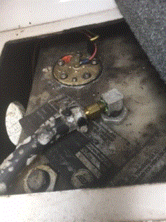

An anti-siphon valve is typically installed at top top of the fuel tank’s pick-up tube fitting..... usually a 90* fitting!
The pick-up tube may be equipped with a screen on the bottom. You may want to remove this tube and inspect the screen as well.
Look at where the fuel is drawn from the tank. There's a fitting or two there, one of which is the anti-syphon valve.

Below a plastic plate ...replacing this year as part of service to the boat, opened it up for the service guys. plate screws were tough, finger tips with small 4" Philips

Ayuh,..... To rule out the supply from the tank,.....
Just hook up a remote tank of clean fresh gas to the fuel filter's hose barb,.....
