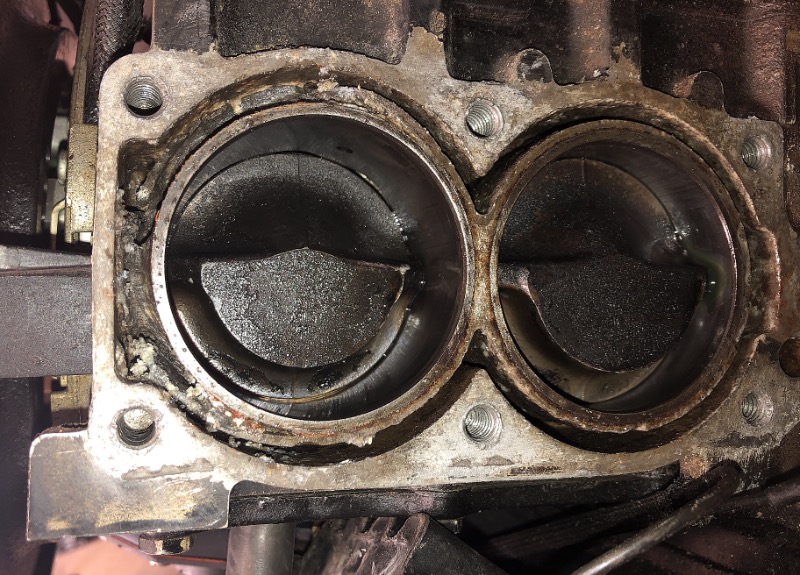

Part of the block around the cylinder sleeve is gone dose this mean I need a new block or can it be fixed
Post pictures.----I might be able to fix it depending on what I see.-----Not sure of what equipment / capability is in your workshop or local area.
As I'm looking at the picture it looks like the cylinder on the right has some scoring. Is that the one with low compression?
Looks like it got really hot.---Aluminum separated from the cast iron liner.----Both cylinders look bad / separated in my humble opinion.-----Hurry and shop for another block.----E-bay is but one place.
Your right, Racer, I see that.....your a much better man than me. That block is garbage, scrap, trash, a boatanchor. I probably have a good block, will check. How about Tim's Outboard....Hackensack MN. 218 682 2331....Mike or Dan. Tell 'em Tim sent ya. 4.9 * review.
Yes it really looks very bad, you need another block. Check also carefully the condition of your pistons and rings and all powerhead bearings because operating temperature is been too high.These engine works are best to do without hurry and when assemble parts back together, keep your hands and environment full clean, specially when working with bearings and cylinders. And remember apply oil to the cylinders and bearings when putting all back together.
Water pump impeller should be changed every 4 or 5 years on that motor.-----They will run and run ( with marginal cooling ) until they go " boom " like this one did
In 1993 they went to a bigger bore cylinder 2.375 " I believe.--And a different method of mounting the recoil starter.------So only a 93 to 2007 block will fit. ----Should not be hard to find I think.
That's right, Racer, all I have left is 92 and back. How about calling Tim's Outboard? Evinrudeman, can you post the picture of that old Merc you restored too? It's beautiful. Especially considering what resources are available there in Finland.
