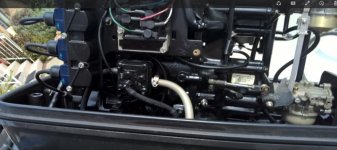

Here I also have a picture of the side engine..to help maybe identify the neutral switch box:

830565 That's the part# for the manual.
Look around you can find manuals on CD for cheap.
You use 32d 28 is for the older Forces.
Mercury installed their electronics and it changed to 32d.
The neutral safety is probably in the shifter.
A pic inside the cowl under the fuel pump will show the old style switch if it's there.
You won't need the switch if you use a jumper at the solenoid.
Just turn the key on and it will energize the system.
Send me a pm with your e-mail if you have any questions.
