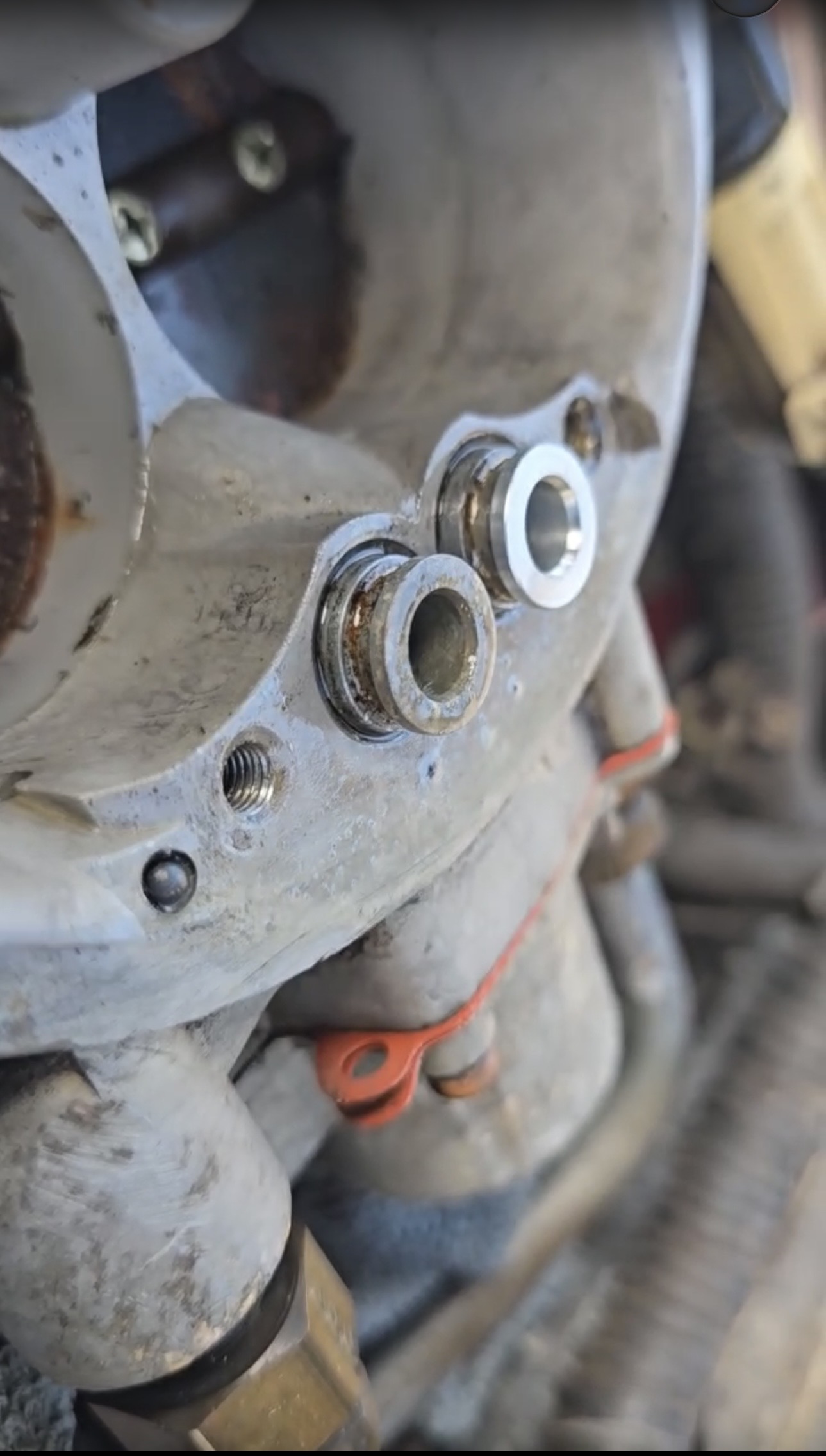

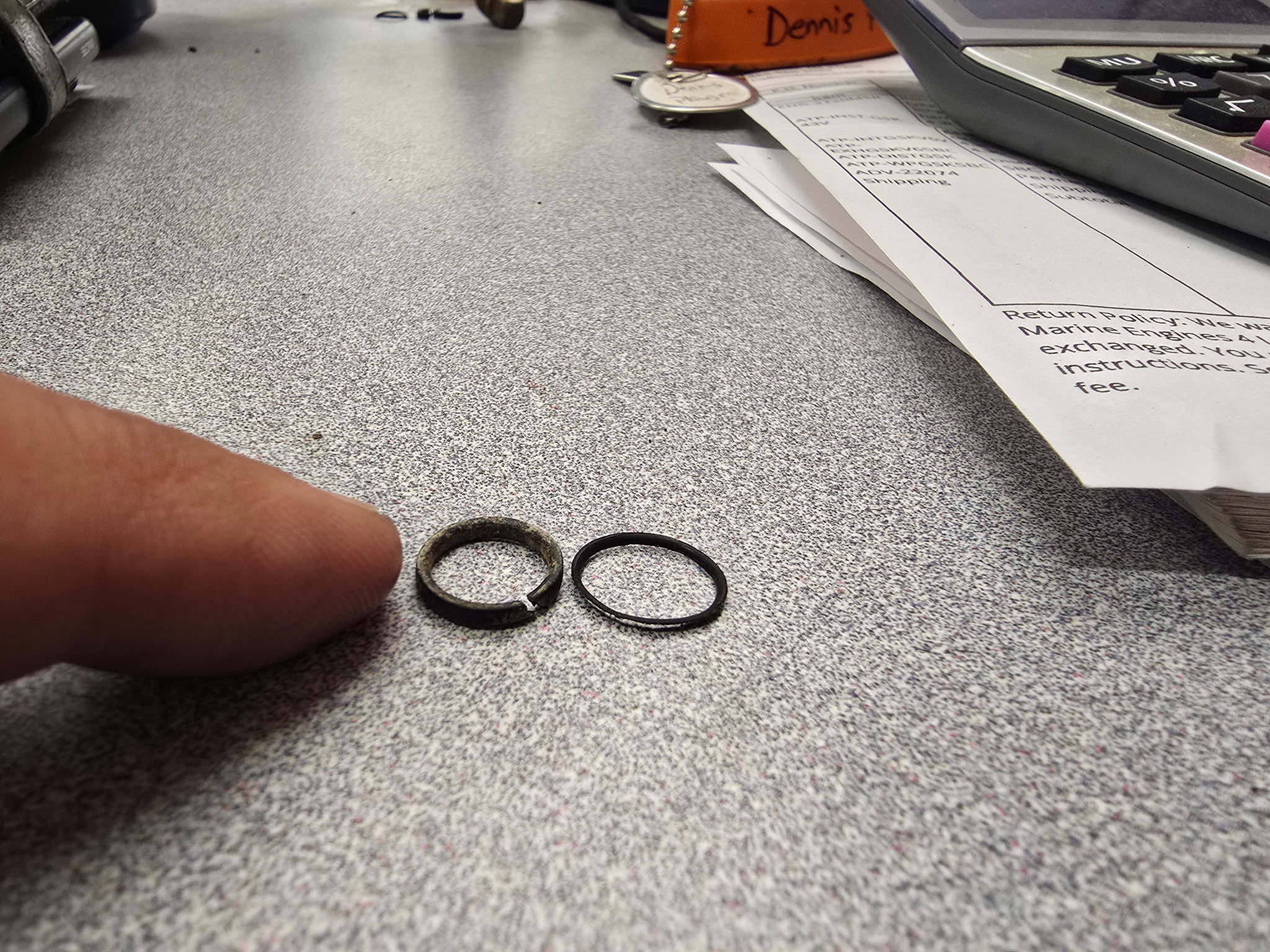

My O-Rings on the male side of the intake going into the bottom side of the throttle body have dry rooted and disintegrated now fuel is spraying everywhere I have been looking all week to find 4 of them if anyone can give me some advice

Find a NAPA store, they should have O-ring assortment made from
Nitrile Rubber (NBR/Buna-N) or Fluoroelastomer (FKM/Viton)
