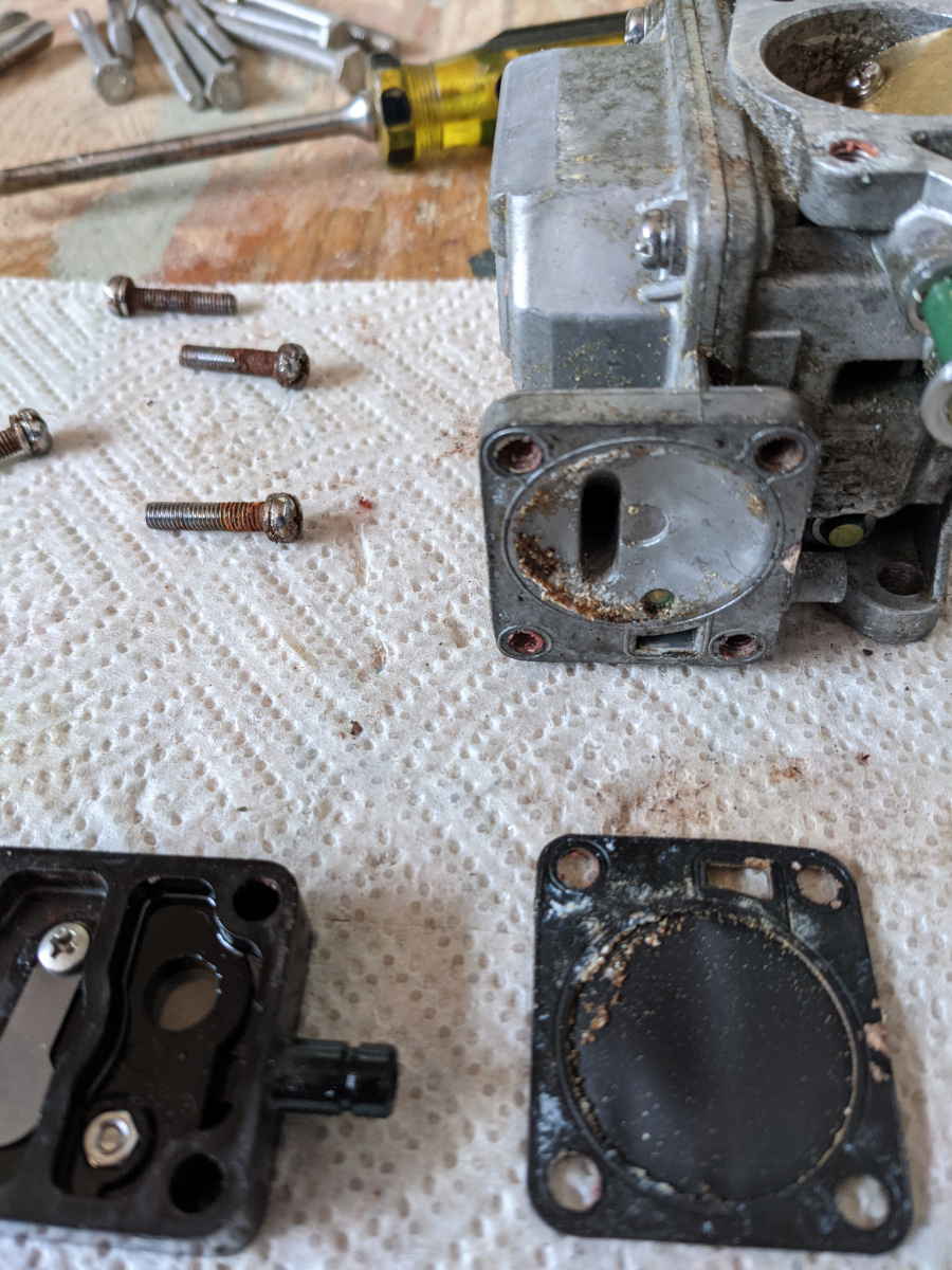

Ok, I took apart the carb again and see I missed the fuel pump last time. Had some corrosion in there that I cleaned up with some WD-40 and some steel wool. Double checked the jet and other pathways and it all looked good. Put it back together and same thing. However.. I opened the throttle up more and it started running but at a higher RPM than I wanted, so started throttling it down and immediately died. Now still hard to start but maybe there's an idle adjusting screw I can sort out. I put up a video of me trying to start it here: http://www.dorydesign.com/downloads/pullstart.mp4
I also put up a video of how the starter behaves. Sorry about the focus, I jury-rigged a stand for my phone and couldn't see what it was focusing on. But it shows what happens: http://www.dorydesign.com/downloads/starter.mp4
I'll include a pic of the pump corrosion. The screws were pretty corroded so wire-wheeled them and added some Tef-Gel.
Pretty corroded. Clearly the low speed circuit of the carb has an issue. Some more cleaning may help, but if it's corrosion only an acid will attack it.
I would pull the starter off again and clean/lubricate it some more.
