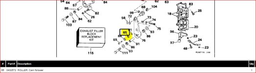

There is a part on the cam roller that can break off. Be sure it is in place. You can look it up on the engine diagrams on this site. It is a plastic sleeve that goes over the cam roller and adds about 1/8" of thickness to it. You won't be able to link and sync correctly without it.[h=1]0432639 - Cam Follower Roller[/h]
There is a part on the cam roller that can break off. Be sure it is in place. You can look it up on the engine diagrams on this site. It is a plastic sleeve that goes over the cam roller and adds about 1/8" of thickness to it. You won't be able to link and sync correctly without it.0432639 - Cam Follower Roller
Looks like it's P/N 432572 on my engine. Previous owner told me it was recently replaced by mechanic, it looks new. Strange that they would do that one and not the others.
