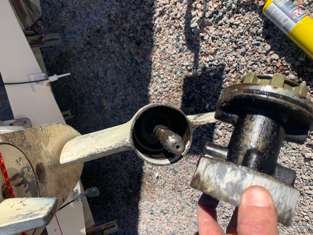

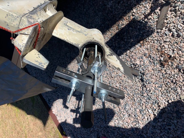

I did get it out. Used a bearing puller tool and some mild heat (propane torch) to the outside of the housing. It came...with a little coaxing...but it came. My plan is to replace the oil seals every season. Should be easier this spring. Hope this helps.
Finally!!! Thanks for the info and help. Had to do a little bush fix engineering on the puller because the 1/4" rods kept bending when there was only two in there. But whew, got it out finally.
It is that white powder ( aluminum oxide ) that forms in there that jams it up.------That is how nature works.----Oxygen joins with the aluminum to form the oxide.-----There is now more material there ( oxygen ) and thus it jams up.------Nature does this one molecule at a time.
Glad to hear it, bro. And glad a novice like me could actually help someone else!
