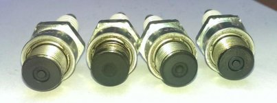

Waited about an hour, then tried to start it up again, but it wouldn't run. Spark plugs and #1 and #2 were black, while #3 and #4 looked clean. I cleaned the plugs and below are the before and after pictures.
