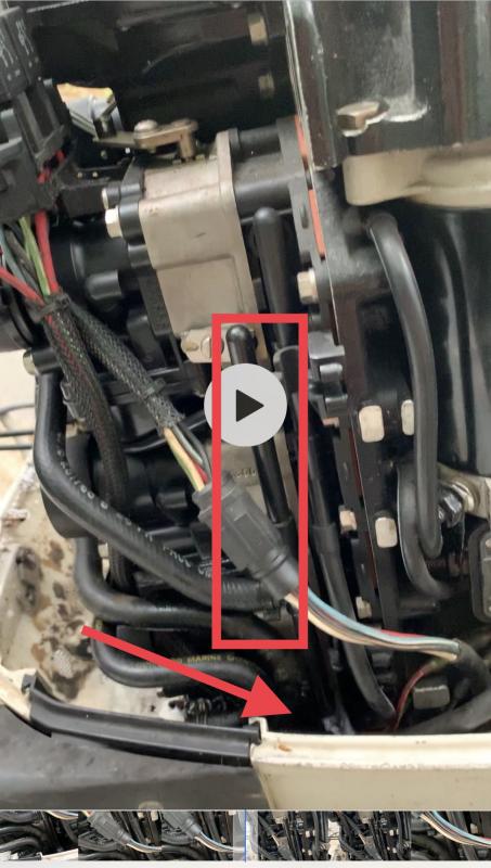

I just started the boat for the first time this year and noticed a leak coming from the side of one of the carbs. It appears to be coming out from behind one of the rails, I’m assuming this is the fuel rail. If so is this just a bad o-ring? Also noticed instead of just seeing plain fuel build up and drip from the front of the carbs, the 3 carbs on this side were milky, the other side looked normal. What would this indicate?
Take it apart and look at it. You could have a piece of crap under the needle and carb cleaner may not get it out.
