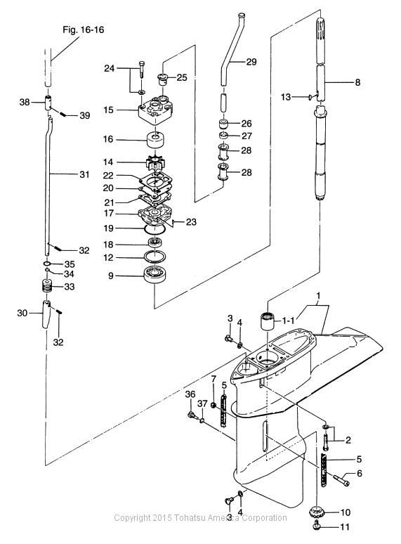

I have pulled the lower unit and drained the oil....all dark oil and no milky coloring so I am going to venture a guess the seals are fine. I also noticed the pump housing was chipped from a former owner who tried to force the two units back together and the rubber grommet which seats on the water pump and seals the pump to the engine cooling water pipe was pretty much toast as well. After purchasing a new pump and seal kit and just before installing the new pump I decided to hook up a water hose directly to the water pipe leading to the engine above and when I turned the water pressure on at the spigot I noticed there was a leak of water coming from the water pipe higher up in the drive housing (low pressure and engine not running) and I was curious if this should leak there or only "spit" out the back of the unit.
This doesnt seem like it would be designed like that but, I am a newbie....so what do I know!
Big question is should this be addressed and pulled apart or is that leak normal? Also, i will be rebuilding the carb tomorrow as well. Any tricks or knowledge of dirty spots to clean would be welcome!
