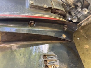

I have a 1992 evinrude VE70TLEND and I cannot see and bolts to remove to drop lower unit to change impeller. Any help? I can provide a pic on what I have.

I want to change the impeller. Just want to drop the bottom end. There are no visible bolts to remove there are just 4 holes. I know there is 1 bolt under the fin.
I have never removed the bolts. That’s how the motor has been for apparently years. Do you know what size these bolts are so a can put them back into place once repair has been made?
The bolts are simple.----They can not be mixed up.-----Or it will be obvious where the bolts go.----Just take the lower unit off.----This job is easy and no overthinking needed.
