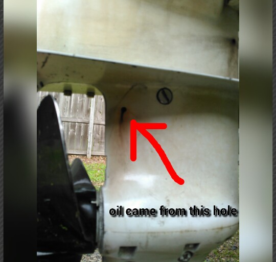

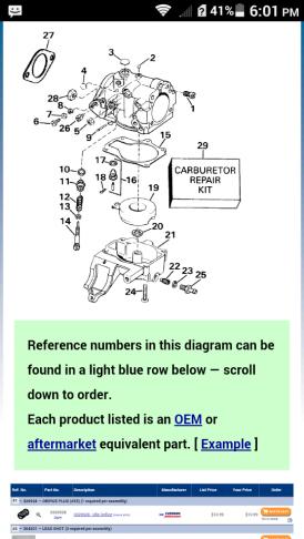

The compression on both were about 105lbs I did pull the wires off one at a time and it is running on both cylinders. Still no luck. Starts and when I give it gas still boggs down and dies. Don't know what to do anymore. I did look at the drawing for the carb I don't know if I should take anything off and clean it. People are saying the jets but I only see the slow speed adjust needle. I also noticed when I was doing the compression test, by the top oil screw for the lower unit there is a water drain hole and it seemed to leak oil from there.
Here are some pictures one of the carb I have in it. The other is where oil was coming out of. I don't know much on outboard engines so I do appreciate all the knowledge and help you have given me. Thank you!

You should get a book on this engine - they are available here on this site too. It will outline all the basic stuff, including rebuilding carbs, which is probably in order if the engine sat for 5 years. Typically "bogging" when you try to accelerate is a lack of fuel caused by clogged jets in the carb.
It sounds like you checked spark as Boobie outlined and compression is OK so most likely you are down to the simple/common thing.
I don't know what that drain hole is exactly but 2 stroke outboards almost always are dripping some sort of black oily goop from someplace around the lower unit. Anything the exhaust touches gets covered in that stuff, add some water, and you have those drips. Usually the cooling water and exhaust both get dumped together someplace prior to exiting the engine resulting in sludge.. Since 2-strokes do not have actual engine oil (they just burn it) for the most part dripping oil, smoke, etc.. etc.. is of no concern.
Now some odd problem might cause more or less such garbage but it's not usually of any trouble-shooting value or worry so I'd ignore it unless somebody points out it's an exception. Gear lube you do not want to be leaking but from your description it doesn't sound like gear lube. With an oil injection system you don't want to see a bunch of leaks there either but similarly it would be clean oil like the stuff you dump in.

Thanks for the advice and knowledge Jon! I will try to see if I can get the top half off of the carb to see if I can get to the jets which I'm sure that's where they are? It seems pretty simple to do I just don't want to mess anything up and damage something. I will see at getting that book for the engine as well.
Hi Stephen,
To rebuild a carb you remove the whole thing, typically then removing the bowl, float, needle, seat, jets, sometimes also welsh plugs. The rest typically stays together (ie butterfly parts do not usually need to come apart).
Parts that are 100% metal you can spray out with carb cleaner, parts that are not 100% metal you cannot use carb cleaner (I use generic WD40 to spray out plastic parts). Compressed air, even just a can of computer duster, is good for drying and blowing out crevices. 100% of any gunk needs to go and it needs to be clean, ie no specs of anything in there.
Once it's clean you put it back together (using a carb rebuild kit for new gaskets, new float/needle/seat), setting the carb float to the correct height by the book. It is really very easy but you do need to pay attention and be careful. The only tools required that might be uncommon is a variety of flat head screw drivers, since it often takes just the right size to remove jets.
