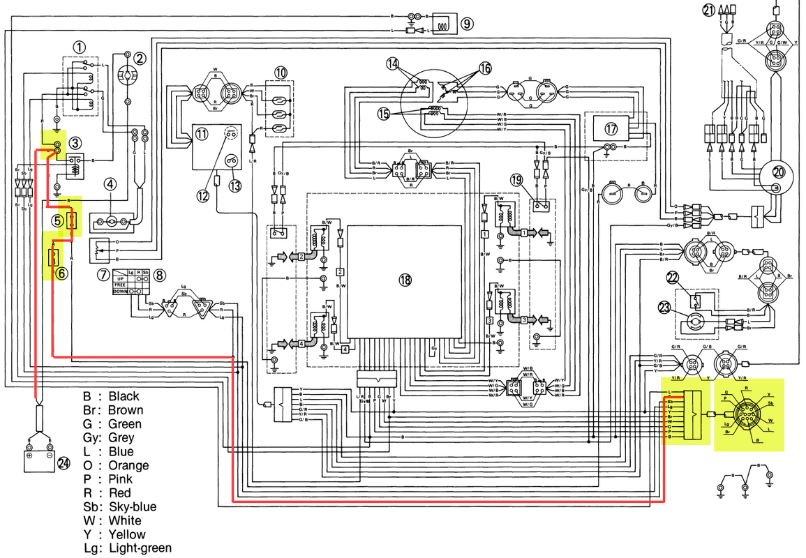

Ok, so I’ve had this boat/motor for 20 years, never a problem in all that time, freshwater and salt. Last trip out in November, I attempted to start the boat at the ramp and first attempt the engine cranked, it usually takes a few attempts. Second try, nothing. After messing with key I heard a pop from the ignition area (my buddy heard it too) so now I’m assuming the ignition switch (side mounted controls) has finally given up.
Over the winter I ordered a new switch. Slightly different, now the choke is built into key switch, replacing the toggle choke, no biggie. Otherwise, wiring seemed pretty straight forward, color coded.
So, I remove the old switch, plug in the new one, get all wires connected to test it. Reconnect the battery, nothing. Just like old switch. No starting, and also no power to he helm. Even in the on position everything is dead. So I grab my volt meter. I found that the red line seems to have 12 volts coming in from one lead, but when I connect all the reds together like they were before and to the ignition switch, the voltage drops to about 2 volts. If I turn ignition to “on” the voltage drops to about a half volt, and when key is turned to “start” it goes down to 0 volts.
What might I be missing and where should I look next. Do I have a short? Does this go out to the helm, or motor? If my starter has failed, would it blackout the whole boat? The only thing that works when the battery is on is the tilt/trim switch mounted on the motor, not the helm one.
