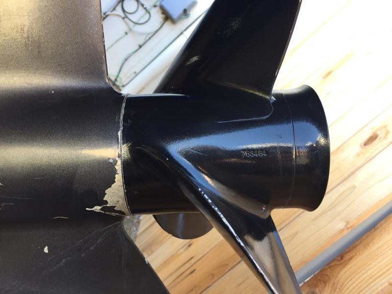

Sorry this has been so long but here is my question. Is the propeller suppose to fit inside the lower casing like it does now, or is it suppose to fit over the lower casing?
Below are the pictures of the current propeller on my outdrive as well as the numbers on the old propeller. I shrunk the pictures down but I think you can see enough in them.
