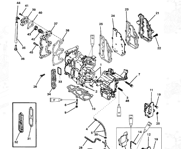

The intake gasket I'm talking about is also called a transfer cover gasket by some.
It's in the diagram below as parts 33/34 or 31/32 in the inset. It covers the transfer of oil/fuel/air from the crankcase into the intake port on the cylinder. You can check around that cover for any signs of an oily mess which could indicate that the gasket(s) are shot.
Some models (all three of mine) have a single paper style gasket. Others had a pair of rubber o-rings (well, rectangular rings I guess).

Yeah, I figured that out after I postedyesterday and looked at the exploded drawing. It seems that gasketis only available in the powerhead gasket kit which they want like$100 for. I'm in Ottawa for the weekend and I'm going to shop aroundfor just that gasket.
