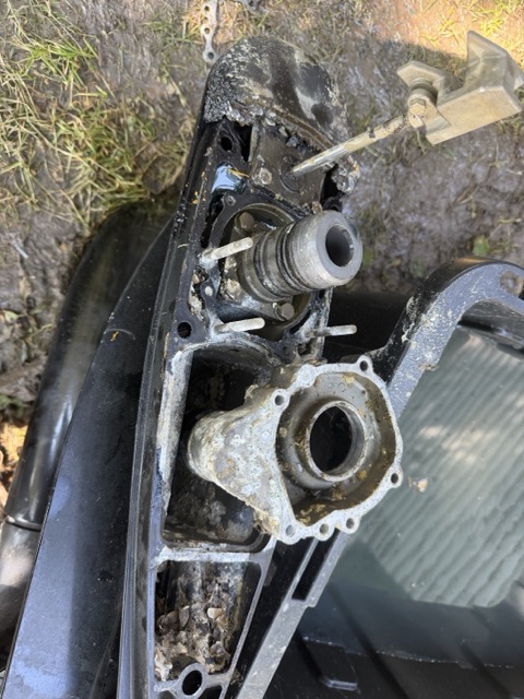

Is there a way I can post pictures on here? The ones I took with my phone won’t post because it says the file is too big. I took the lower unit off and the cover where the impeller would be and it looks like the style mine is doesn’t use an impeller outside of the boat but I don’t see what pumps the water up and into the engine for the engine water pump to circulate it.

Sorry this is my first boat I’ve ever messed with and all I know is the model they put on the title and the outer unit has been painted so there is no stickers for me to know what it is.
Got the pictures resized thanks for mentioning how to do that.

This engine and drive are NOT MERCRUISER.
Best to visit the forum for that brand.
Either Volvo Penta or OMC

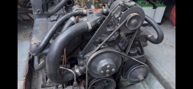

Looks like mine is the omc cobra, thank you for mentioning that. It is behind a cover above the lower unit that I took off. There was no stickers or labels so I had no clue how to look up what was working on but I found it now that you mentioned omc so that’s what I was looking for. Thanks, this is what mine looks like.
